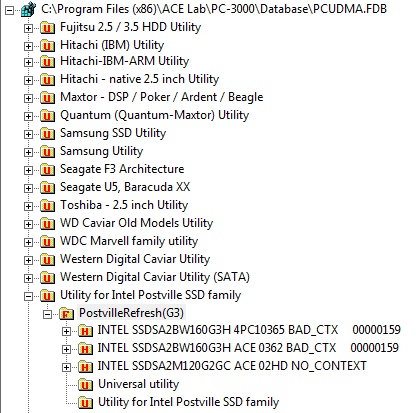

Sometimes PC-3000 database can get a problem with the folders location.
One or more folders from the root are moved to the other place.
For example on this screenshot you can see that HDD profile folders are moved in to the SSD tool profile folder:
Such behavior caused by problems with database service in OS or critical shutdown of this DB.
How to solve such problem?
Here you can download the script file that will move profile folders to the correct place in the PC-3000 Database.
Go to the “Scripts” window in PC-3000
Use the “Import” button and select this script file on your PC
Then select it and execute this script.
As you can see now Profile folders have a correct location in the PC-3000 Database.
