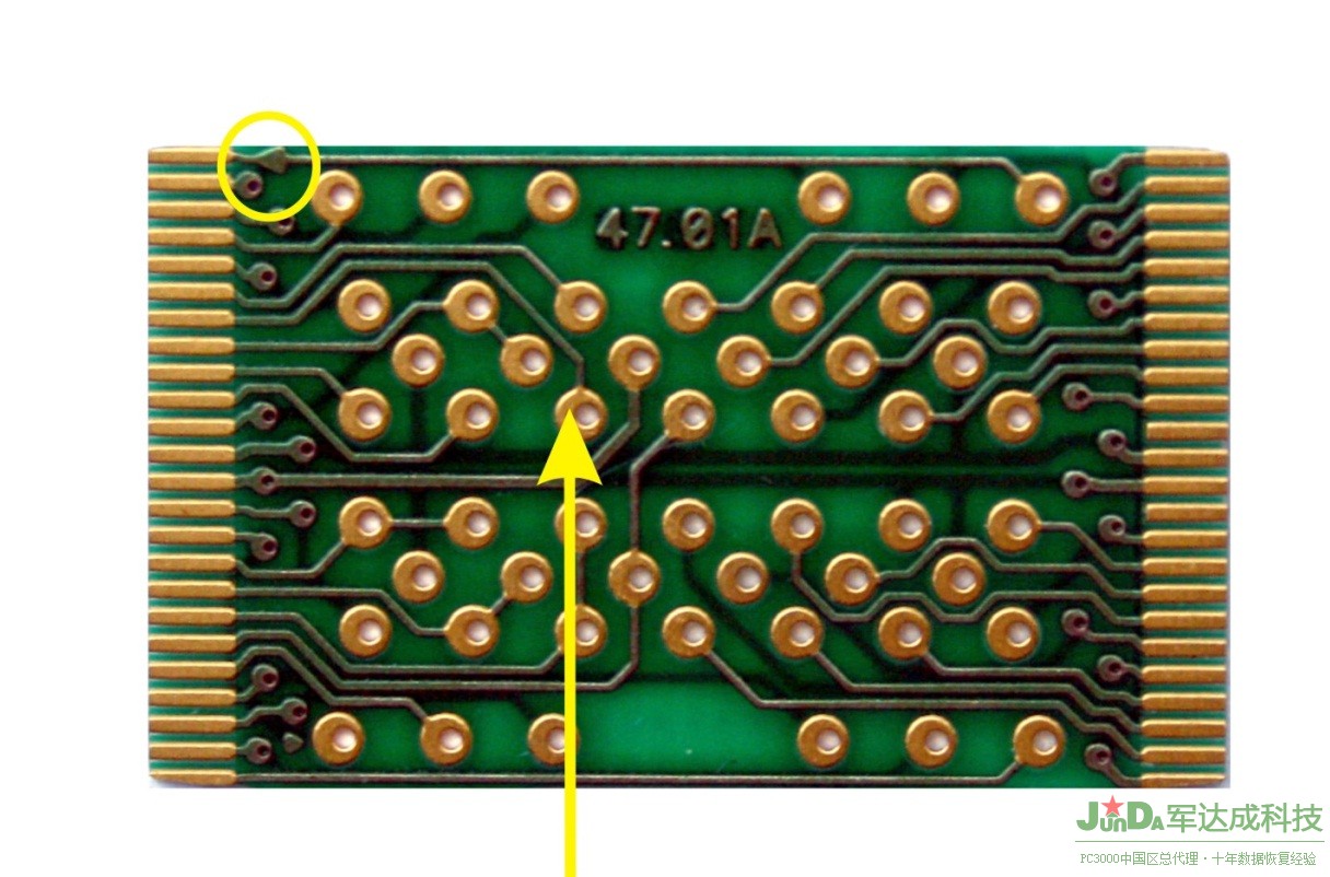

在某些情况下,需要手工焊接线路,为了方便朋友们,请看下图.
LGA-52 adapter(芯片转接适配器)
LGA52
LGA52 适配图
引角定义:
No.    x8        x16
PIN 1 CTRL CTRL
PIN 2 CTRL CTRL
PIN 3 CTRL CTRL
PIN 4 R/#B4 R/#B4
PIN 5 R/#B3 R/#B3
PIN 6 R/#B2 R/#B2
PIN 7 R/#B1 R/#B1
PIN 8 #RE #RE
PIN 9 #CE1 #CE1
PIN 10 #CE2 #CE2
PIN 11 CTRL CTRL
PIN 12 Vcc Vcc
PIN 13 Vss Vss
PIN 14 #CE3 #CE3
PIN 15 #CE4 #CE4
PIN 16 CLE CLE
PIN 17 ALE ALE
PIN 18 #WE #WE
PIN 19 #WP #WP
PIN 20 CTRL CTRL
PIN 21 CTRL CTRL
PIN 22 CTRL CTRL
PIN 23 CTRL CTRL
PIN 24 CTRL CTRL
PIN 48 Vss Vss
PIN 47 NC IO15
PIN 46 NC IO7
PIN 45 NC IO14
PIN 44 IO7 IO6
PIN 43 IO6 IO13
PIN 42 IO5 IO5
PIN 41 IO4 IO12
PIN 40 NC IO4
PIN 39 CTRL CTRL
PIN 38 CTRL CTRL
PIN 37 Vcc Vcc
PIN 36 Vss Vss
PIN 35 CTRL CTRL
PIN 34 CTRL CTRL
PIN 33 NC IO11
PIN 32 IO3 IO3
PIN 31 IO2 IO10
PIN 30 IO1 IO2
PIN 29 IO0 IO9
PIN 28 NC IO1
PIN 27 NC IO8
PIN 26 NC IO0
PIN 25 Vss Vss
