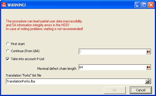

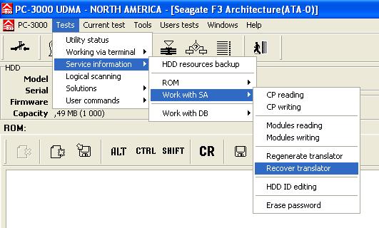

PC3000 For windows UDMA 全面解决希捷硬盘典型故障。数据恢复,恢复数据,安全方案。ST 7200.11 7200.12 5400.6 前面扇区正常,后面不能访问解决方法。First.
Full automatic solution. You should launch option that is shown on the picture below使用PC3000UDMA 4.67版本 新增 恢复编译器功能
Then you will see window where you can select "First start" of procedure or "Continue from LBA".
If you know that P list is damaged you should unmark "Take into account P-list"选 First start 点OK.
So if you launch this solution first time and suppose that P list is OK you should just press on the "OK" button and wait till end of procedure.
It may take long time.这将持续时间比较长。

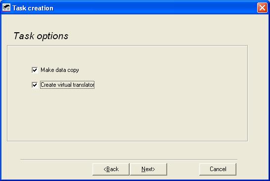

Task in DE.
If you want to use this solution you should create task in DE in mode "Create virtual translator" (and "make data copy" of course).如果恢复编译器出现错误,我们可以用另一种方法-PC3000UDMA-DE 恢复数据。DE可以直接读取固件损坏的硬盘数据。如编译器损坏。进入DE时注意要选 Create virtual translator" 和 "make data copy" 因为缺陷表损坏的硬盘必须要用建立虚拟编译器功能。

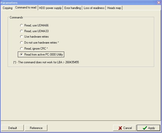

Then you should select reading mode "Read from active utility"选 Read from active PC3000 utility
In this mode reading will be slowly than in UDMA mode. But you will get full image of disk with shifts.
Then you should create virtual translator via menu of DE.读取数据速度是非常慢的,但是你将获得数据。你能使用建立虚拟的编译器功能-Create virtual translator.恢复出完整目录。
