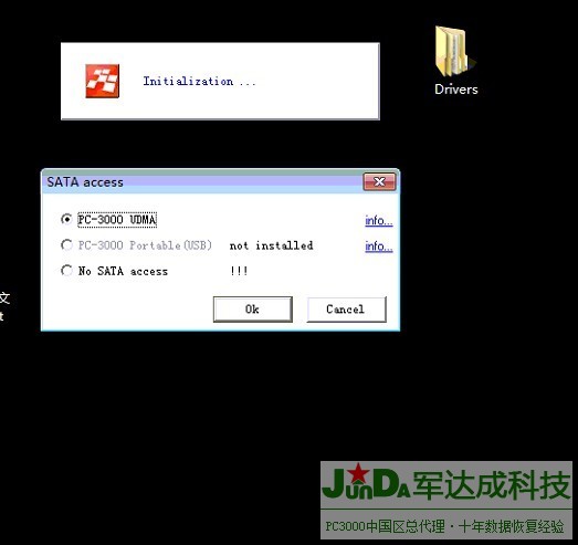

2.
默认选择PC-3000 UDMA 端口
3.

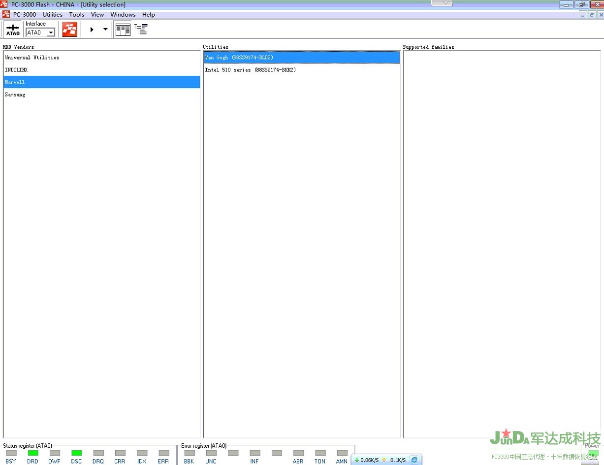

进 入程序,选择对应主控系列.
4.
进入专用程序系列

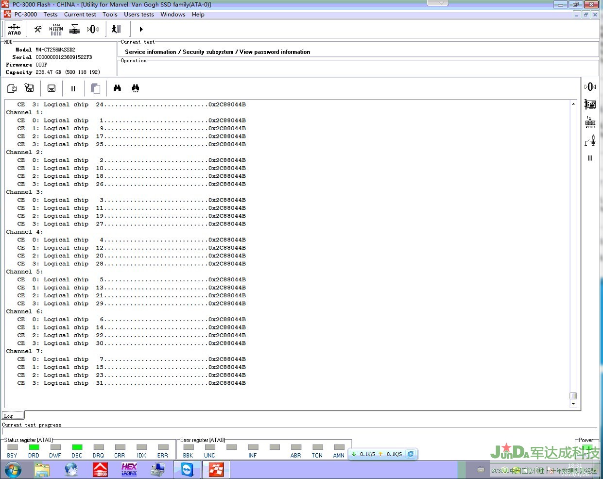

日志文件如下:
Capacity (MB).........................................262144
Logical reading.......................................Yes
Chanels count.........................................8
Channel 0:
   CE  0: Logical chip   0............................0x2C88044B
   CE  1: Logical chip   8............................0x2C88044B
   CE  2: Logical chip  16............................0x2C88044B
   CE  3: Logical chip  24............................0x2C88044B
Channel 1:
   CE  0: Logical chip   1............................0x2C88044B
   CE  1: Logical chip   9............................0x2C88044B
   CE  2: Logical chip  17............................0x2C88044B
   CE  3: Logical chip  25............................0x2C88044B
Channel 2:
   CE  0: Logical chip   2............................0x2C88044B
   CE  1: Logical chip  10............................0x2C88044B
   CE  2: Logical chip  18............................0x2C88044B
   CE  3: Logical chip  26............................0x2C88044B
Channel 3:
   CE  0: Logical chip   3............................0x2C88044B
   CE  1: Logical chip  11............................0x2C88044B
   CE  2: Logical chip  19............................0x2C88044B
   CE  3: Logical chip  27............................0x2C88044B
Channel 4:
   CE  0: Logical chip   4............................0x2C88044B
   CE  1: Logical chip  12............................0x2C88044B
   CE  2: Logical chip  20............................0x2C88044B
   CE  3: Logical chip  28............................0x2C88044B
Channel 5:
   CE  0: Logical chip   5............................0x2C88044B
   CE  1: Logical chip  13............................0x2C88044B
   CE  2: Logical chip  21............................0x2C88044B
   CE  3: Logical chip  29............................0x2C88044B
Channel 6:
   CE  0: Logical chip   6............................0x2C88044B
   CE  1: Logical chip  14............................0x2C88044B
   CE  2: Logical chip  22............................0x2C88044B
   CE  3: Logical chip  30............................0x2C88044B
Channel 7:
   CE  0: Logical chip   7............................0x2C88044B
   CE  1: Logical chip  15............................0x2C88044B
   CE  2: Logical chip  23............................0x2C88044B
   CE  3: Logical chip  31............................0x2C88044B

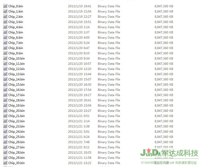

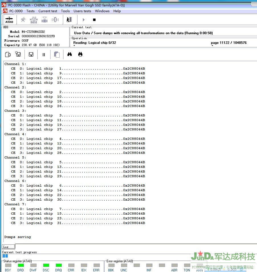

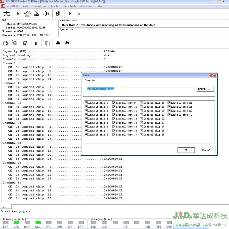

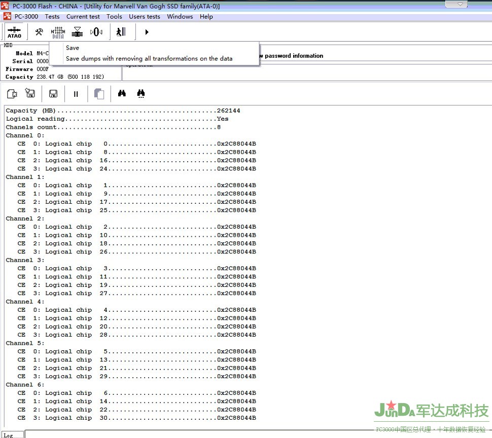

5.读取芯片数据
选择左上角第三个图标,DATA
之后有2种保存芯片数据的模式可以选择,
1.Save 保存
2.Save dumps with removing all transformations on the data 在数据上移除全部的数据转换(如XOR ,INVERT)并保存芯片数据DUMPS.
6.
选择保存文件的位置.
7.
开始读取芯片,正在读逻辑芯片0,页数量,1048576.
8.芯片读取完成.

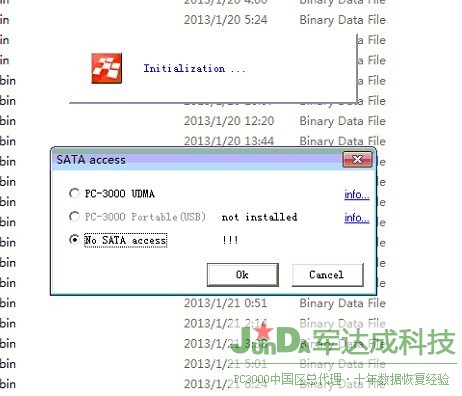

启动FLASH 程序 选择 No SATA access !!!   (不用SATA 访问)

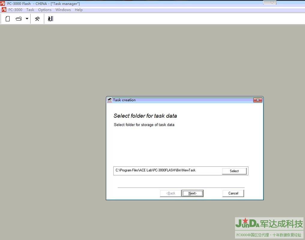

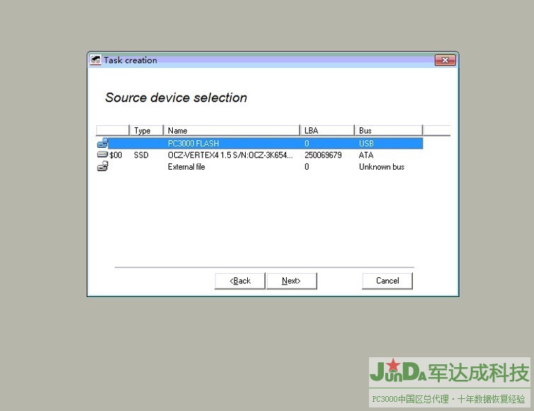

新建立任务,选左上角第一个图标,弹出 建立任务菜单. 之后选择任务文件夹.
11. 来源设备选择,选 PC3000 FLASH

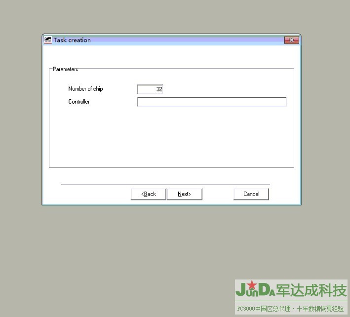

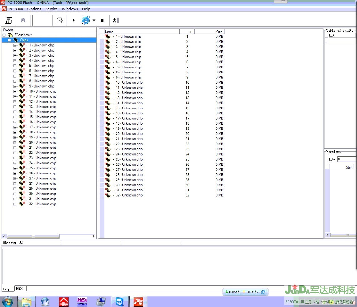

在参数菜单中选 择芯片的数量. 以芯片DUMP 的数量为准.在这里我们输入32.
13.

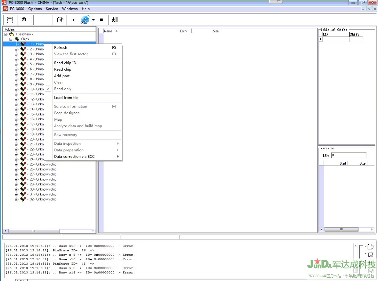

进入程序后双击 Chips,显示 32个芯片图标.之后,我们需要加载外部DUMP 文件

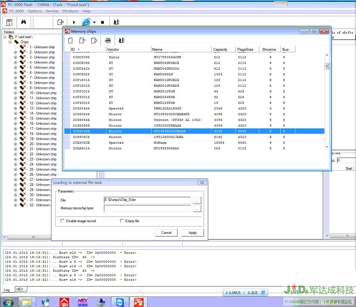

14.加载外部DUMPS文件,之前已经读取成功的文件.在X号上点鼠标右键,选Load from file加载从文件.
(如果U盘,相机卡等,也可以在这里X号上点鼠标右键,选Read chip ,用FLASH 盒子读取芯片)
15.在加载外部的文件菜单,1.选择文件的位置,File: ,2.选择存储芯片类型 Memory microchip type: 之后点应用 Apply.
16.

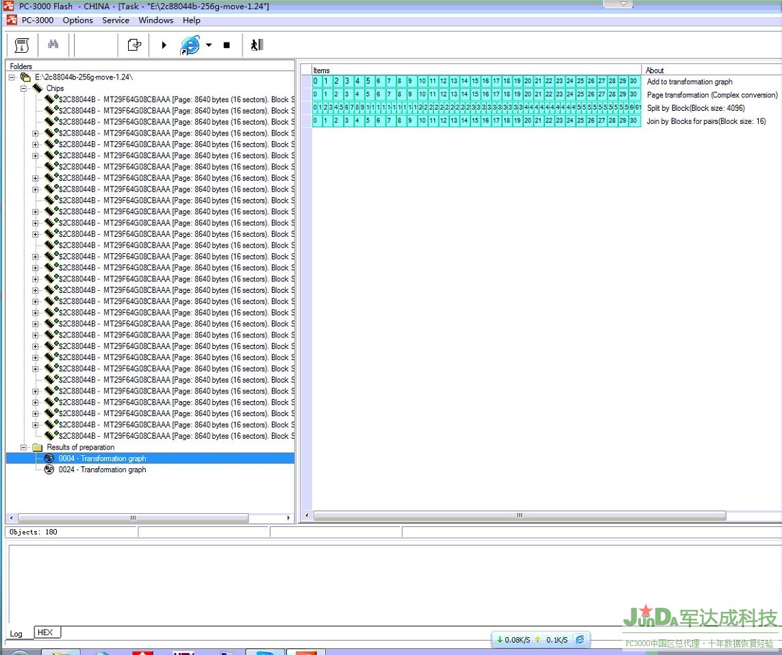

逐个文件导入成功后由下图所示.

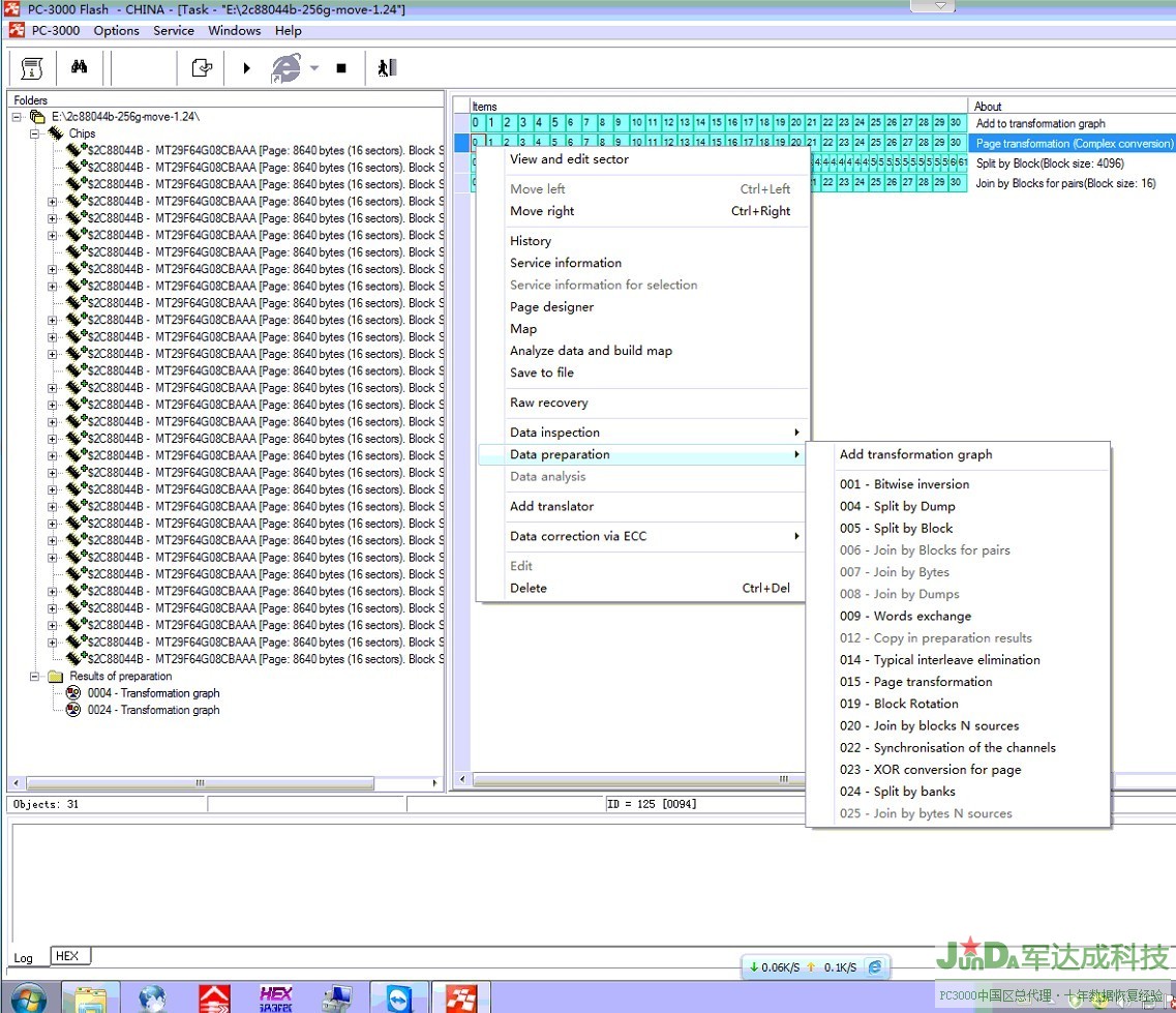

然后 ,在左上角Chip 处单击鼠标右键,在数据准备Data preparation 选择添加图形转换.Add transformation graph,
之后,在数据准备Data preparation 选择页转换page transformation .
之后,在数据准备Data preparation 依次选 择 5.6, 分离(split by Block) 4096 .结合(Join by Blocks for pairs)16.
本例在之后还需要 Join 16 ,join 64, 等方法移除数据交错. 最后依据主控,块大小,建立映像.获得数据.
一些菜单见下图.
