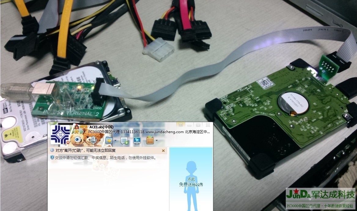

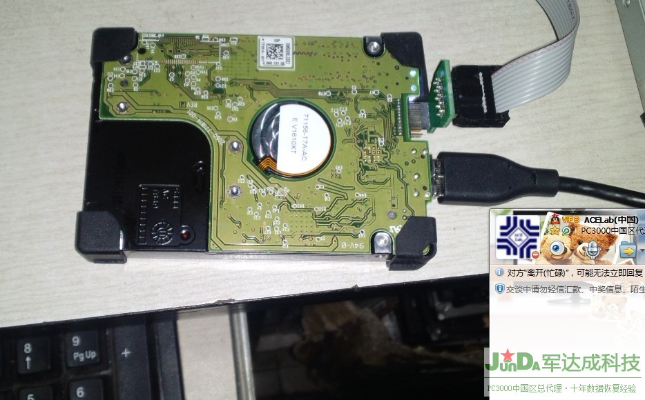

首先,硬件连接如下图:
COM转接头用 Samsung(三星)代用,完全通用!
如图:Samsung(三星)COM转接头 靠最下面排针左侧插入!!!

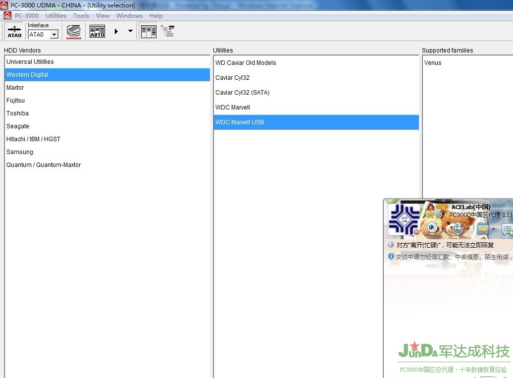

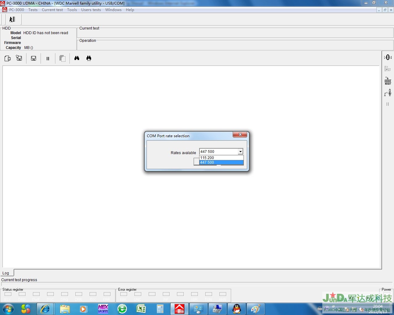

然后,进入西数USB专修程序 : WDC Marvell USB

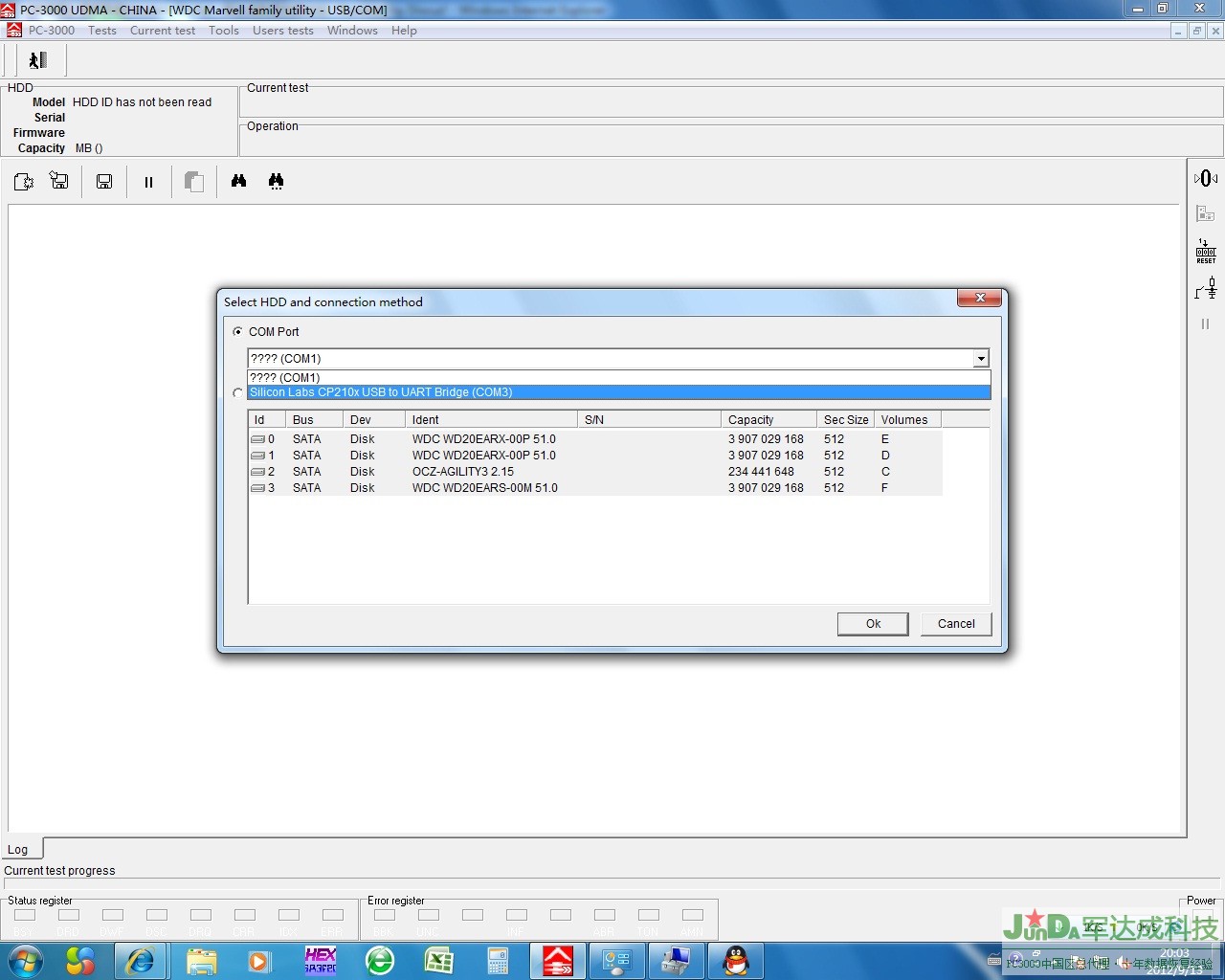

选择COM 端口: Silicon Labs CP210x USB to UART Bridge(COM3)
选择COM端口速率为115200

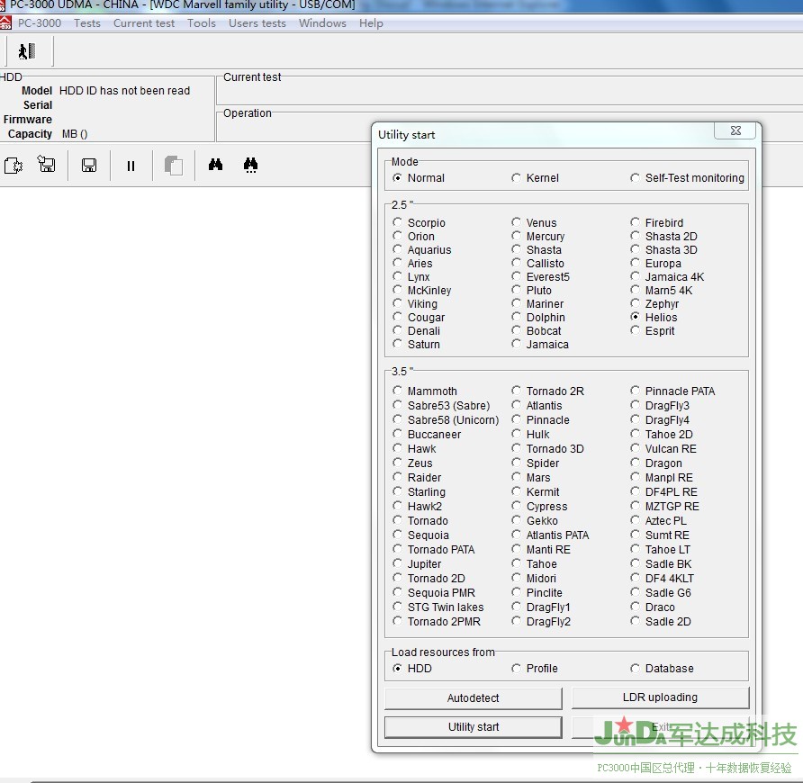

自动发现硬盘家族系列:Autodetect, 发现硬盘家族:Helios ,然后点击:Utility start

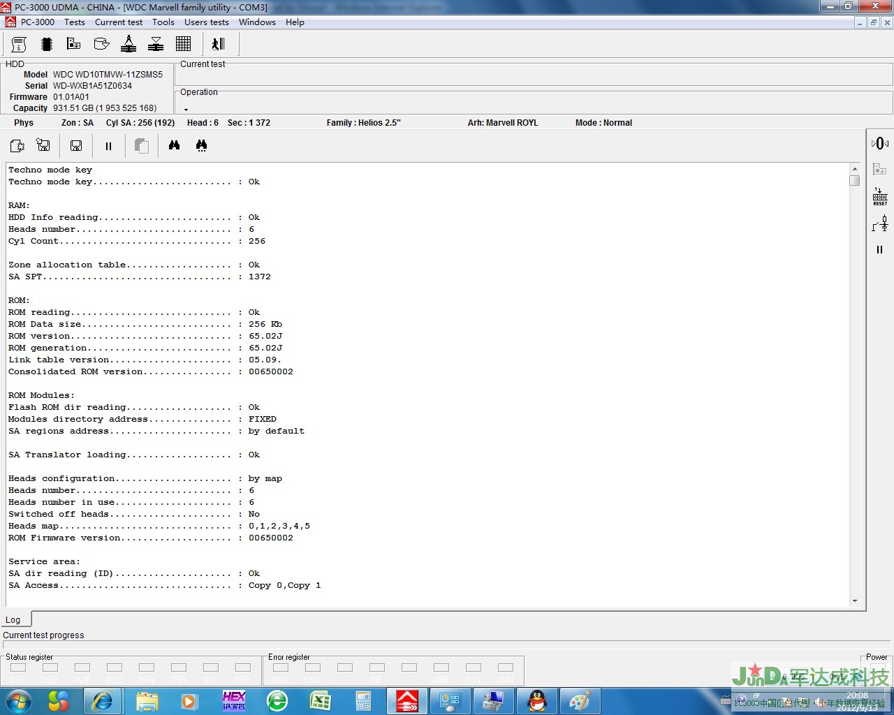

进入 USB西数专修程序,如下图:
程序日志如下:
Techno mode key
Techno mode key......................... : Ok
RAM:
HDD Info reading........................ : Ok
Heads number............................ : 6
Cyl Count............................... : 256
Zone allocation table................... : Ok
SA SPT.................................. : 1372
ROM:
ROM reading............................. : Ok
ROM Data size........................... : 256 Kb
ROM version............................. : 65.02J
ROM generation.......................... : 65.02J
Link table version...................... : 05.09.
Consolidated ROM version................ : 00650002
ROM Modules:
Flash ROM dir reading................... : Ok
Modules directory address............... : FIXED
SA regions address...................... : by default
SA Translator loading................... : Ok
Heads configuration..................... : by map
Heads number in use..................... : 6
Switched off heads...................... : No
Heads map............................... : 0,1,2,3,4,5
ROM Firmware version.................... : 00650002
Service area:
SA dir reading (ID)..................... : Ok
SA Access............................... : Copy 0,Copy 1
Configuration reading................... : Ok
Master Password......................... : has not been set
User Password........................... : has not been set
3针三星COM口接WD-USB 一体盘接法。
