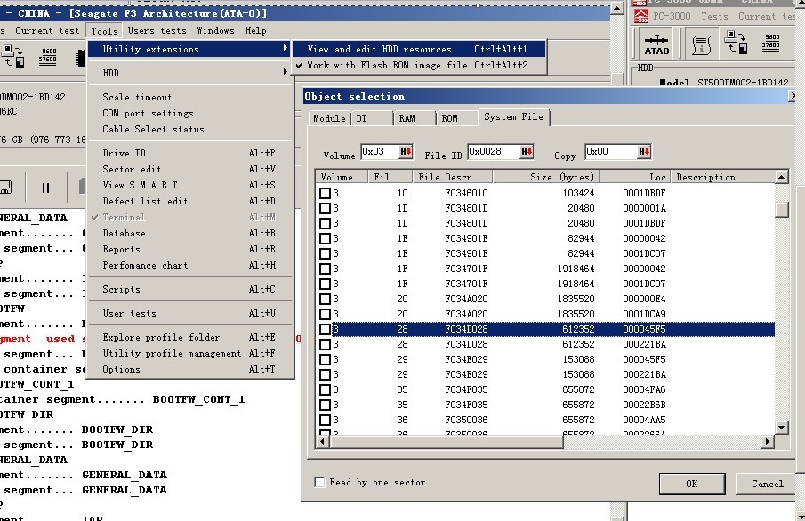

此问题最快数据恢复方案:
用PC3000UDMA 终端,直接写系统文件 03  346 . 成功几率99.9%。 整个时间不会超过3分钟。
就是这样简单!详细日志如下:

新版本加入LDR建立和加载功能。
好硬盘读取系统文件,正常。日志如下:

接上坏硬盘调到高速率,读系统文件日志如下:
Test  : Reading System Files
Reading System Files to profile folder
Folder: C:\Program Files\ACE Lab\PC-3000\Bin\!Profiles\SgF3\Pharaoh\3F 500G\Data
Copies : 0 1
Rd Sys File: vol = 0, FID = 000, Copy = 000...
Receiving file  FILE_0_000_0, length = 2048
Sys File FD000000(0).................................................. : Ok
Rd Sys File: vol = 0, FID = 000, Copy = 001...
Receiving file  FILE_0_000_1, length = 2048
Sys File FD000000(1).................................................. : Ok
Rd Sys File: vol = 0, FID = 203, Copy = 000...
Receiving file  FILE_0_203_0, length = 4096
Sys File FC001203(0).................................................. : Ok
Rd Sys File: vol = 0, FID = 203, Copy = 001...
Receiving file  FILE_0_203_1, length = 4096
Sys File FC001203(1).................................................. : Ok
Rd Sys File: vol = 0, FID = 204, Copy = 000...
Receiving file  FILE_0_204_0, length = 1536
Sys File FC002204(0).................................................. : Ok
Rd Sys File: vol = 0, FID = 204, Copy = 001...
Receiving file  FILE_0_204_1, length = 1536
Sys File FC002204(1).................................................. : Ok
Rd Sys File: vol = 0, FID = 205, Copy = 000...
Receiving file  FILE_0_205_0, length = 1024
Sys File FC003205(0).................................................. : Ok
Rd Sys File: vol = 0, FID = 205, Copy = 001...
Receiving file  FILE_0_205_1, length = 1024
Sys File FC003205(1).................................................. : Ok
Rd Sys File: vol = 0, FID = 206, Copy = 000...
Receiving file  FILE_0_206_0, length = 1024
Sys File FC004206(0).................................................. : Ok
Rd Sys File: vol = 0, FID = 206, Copy = 001...
Receiving file  FILE_0_206_1, length = 1024
Sys File FC004206(1).................................................. : Ok
Rd Sys File: vol = 0, FID = 20C, Copy = 000...
Receiving file  FILE_0_20C_0, length = 197120
Sys File FC00520C(0).................................................. : Ok
Rd Sys File: vol = 0, FID = 20C, Copy = 001...
Receiving file  FILE_0_20C_1, length = 197120
Sys File FC00520C(1).................................................. : Ok
Rd Sys File: vol = 0, FID = 20D, Copy = 000...
Receiving file  FILE_0_20D_0, length = 921600
Sys File FC00620D(0).................................................. : Ok
Rd Sys File: vol = 0, FID = 20D, Copy = 001...
Receiving file  FILE_0_20D_1, length = 921600
Sys File FC00620D(1).................................................. : Ok
Rd Sys File: vol = 0, FID = 20E, Copy = 000...
Receiving file  FILE_0_20E_0, length = 921600
Sys File FC00720E(0).................................................. : Ok
Rd Sys File: vol = 0, FID = 20E, Copy = 001...
Receiving file  FILE_0_20E_1, length = 921600
Sys File FC00720E(1).................................................. : Ok
Rd Sys File: vol = 3, FID = 001, Copy = 000...
Receiving file  FILE_3_001_0, length = 33792
Sys File FC342001(0).................................................. : Ok
Rd Sys File: vol = 3, FID = 001, Copy = 001...
Receiving file  FILE_3_001_1, length = 33792
Sys File FC342001(1).................................................. : Ok
Rd Sys File: vol = 3, FID = 019, Copy = 000...
Receiving file  FILE_3_019_0, length = 8192
Sys File FC343019(0).................................................. : Ok
Rd Sys File: vol = 3, FID = 019, Copy = 001...
Receiving file  FILE_3_019_1, length = 8192
Sys File FC343019(1).................................................. : Ok
Rd Sys File: vol = 3, FID = 01A, Copy = 000...
Receiving file  FILE_3_01A_0, length = 1024
Sys File FC34401A(0).................................................. : Ok
Rd Sys File: vol = 3, FID = 01A, Copy = 001...
Receiving file  FILE_3_01A_1, length = 1024
Sys File FC34401A(1).................................................. : Ok
Rd Sys File: vol = 3, FID = 01B, Copy = 000...
Receiving file  FILE_3_01B_0, length = 1938944
Sys File FC34501B(0).................................................. : Ok
Rd Sys File: vol = 3, FID = 01B, Copy = 001...
Receiving file  FILE_3_01B_1, length = 1938944
Sys File FC34501B(1).................................................. : Ok
Rd Sys File: vol = 3, FID = 01C, Copy = 000...
Receiving file  FILE_3_01C_0, length = 103424
Sys File FC34601C(0).................................................. : Ok
Rd Sys File: vol = 3, FID = 01C, Copy = 001...
Receiving file  FILE_3_01C_1, length = 103424
Sys File FC34601C(1).................................................. : Ok
Rd Sys File: vol = 3, FID = 01D, Copy = 000...
Receiving file  FILE_3_01D_0, length = 20480
Sys File FC34801D(0).................................................. : Ok
Rd Sys File: vol = 3, FID = 01D, Copy = 001...
Receiving file  FILE_3_01D_1, length = 20480
Sys File FC34801D(1).................................................. : Ok
Rd Sys File: vol = 3, FID = 01E, Copy = 000...
Receiving file  FILE_3_01E_0, length = 82944
Sys File FC34901E(0).................................................. : Ok
Rd Sys File: vol = 3, FID = 01E, Copy = 001...
Receiving file  FILE_3_01E_1, length = 82944
Sys File FC34901E(1).................................................. : Ok
Rd Sys File: vol = 3, FID = 01F, Copy = 000...
Receiving file  FILE_3_01F_0, length = 1918464
Sys File FC34701F(0).................................................. : Ok
Rd Sys File: vol = 3, FID = 01F, Copy = 001...
Receiving file  FILE_3_01F_1, length = 1918464
Sys File FC34701F(1).................................................. : Ok
Rd Sys File: vol = 3, FID = 020, Copy = 000...
Receiving file  FILE_3_020_0, length = 1835520
Sys File FC34A020(0).................................................. : Ok
Rd Sys File: vol = 3, FID = 020, Copy = 001...
Receiving file  FILE_3_020_1, length = 1835520
Sys File FC34A020(1).................................................. : Ok
Rd Sys File: vol = 3, FID = 028, Copy = 000...
Receiving file  FILE_3_028_0, length = 612352
Sys File FC34D028(0).................................................. : Ok
Rd Sys File: vol = 3, FID = 028, Copy = 001...
Receiving file  FILE_3_028_1, length = 612352
Sys File FC34D028(1).................................................. : Ok
Rd Sys File: vol = 3, FID = 029, Copy = 000...
Receiving file  FILE_3_029_0, length = 153088
Sys File FC34E029(0).................................................. : Ok
Rd Sys File: vol = 3, FID = 029, Copy = 001...
Receiving file  FILE_3_029_1, length = 153088
Sys File FC34E029(1).................................................. : Ok
Rd Sys File: vol = 3, FID = 035, Copy = 000...
Receiving file  FILE_3_035_0, length = 655872
Sys File FC34F035(0).................................................. : Ok
Rd Sys File: vol = 3, FID = 035, Copy = 001...
Receiving file  FILE_3_035_1, length = 655872
Sys File FC34F035(1).................................................. : Ok
Rd Sys File: vol = 3, FID = 036, Copy = 000...
Receiving file  FILE_3_036_0, length = 655872
Sys File FC350036(0).................................................. : Ok
Rd Sys File: vol = 3, FID = 036, Copy = 001...
Receiving file  FILE_3_036_1, length = 655872
Sys File FC350036(1).................................................. : Ok
Rd Sys File: vol = 3, FID = 037, Copy = 000...

Sys File FC38713E(1).................................................. : Ok
Rd Sys File: vol = 3, FID = 13F, Copy = 000...
Receiving file  FILE_3_13F_0, length = 262144
Sys File FC38813F(0).................................................. : Ok
Rd Sys File: vol = 3, FID = 13F, Copy = 001...
Receiving file  FILE_3_13F_1, length = 262144
Sys File FC38813F(1).................................................. : Ok
Rd Sys File: vol = 3, FID = 140, Copy = 000...
Receiving file  FILE_3_140_0, length = 10240
Sys File FC389140(0).................................................. : Ok
Rd Sys File: vol = 3, FID = 140, Copy = 001...
Receiving file  FILE_3_140_1, length = 10240
Sys File FC389140(1).................................................. : Ok
Rd Sys File: vol = 3, FID = 141, Copy = 000...
Receiving file  FILE_3_141_0, length = 51712
Sys File FC38A141(0).................................................. : Ok
Rd Sys File: vol = 3, FID = 141, Copy = 001...
Receiving file  FILE_3_141_1, length = 51712
Sys File FC38A141(1).................................................. : Ok
Rd Sys File: vol = 3, FID = 143, Copy = 000...
Receiving file  FILE_3_143_0, length = 512
Sys File FC390143(0).................................................. : Ok
Rd Sys File: vol = 3, FID = 143, Copy = 001...
Receiving file  FILE_3_143_1, length = 512
Sys File FC390143(1).................................................. : Ok
Rd Sys File: vol = 3, FID = 144, Copy = 000...
Receiving file  FILE_3_144_0, length = 512
Sys File FC392144(0).................................................. : Ok
Rd Sys File: vol = 3, FID = 144, Copy = 001...
Receiving file  FILE_3_144_1, length = 512
Sys File FC392144(1).................................................. : Ok
Rd Sys File: vol = 3, FID = 14E, Copy = 000...
Receiving file  FILE_3_14E_0, length = 4096
Sys File FC37214E(0).................................................. : Ok
Rd Sys File: vol = 3, FID = 14E, Copy = 001...
Receiving file  FILE_3_14E_1, length = 4096
Sys File FC37214E(1).................................................. : Ok
Rd Sys File: vol = 3, FID = 14F, Copy = 000...
Receiving file  FILE_3_14F_0, length = 49152
Sys File FC31014F(0).................................................. : Ok
Rd Sys File: vol = 3, FID = 14F, Copy = 001...
Root Sys File Rd Err!
HDD power supply switching OFF/ON...
Sys File FC31014F(1).................................................. : Error
Error : Can not read!
Rd Sys File: vol = 3, FID = 150, Copy = 000...
Receiving file  FILE_3_150_0, length = 49152
Sys File FC311150(0).................................................. : Ok
Rd Sys File: vol = 3, FID = 150, Copy = 001...
Sys File FC311150(1).................................................. : Error
Rd Sys File: vol = 3, FID = 151, Copy = 000...
Receiving file  FILE_3_151_0, length = 49152
Sys File FC312151(0).................................................. : Ok
Rd Sys File: vol = 3, FID = 151, Copy = 001...
Sys File FC312151(1).................................................. : Error
Rd Sys File: vol = 3, FID = 152, Copy = 000...
Receiving file  FILE_3_152_0, length = 184320
Sys File FC313152(0).................................................. : Ok
Rd Sys File: vol = 3, FID = 152, Copy = 001...
Sys File FC313152(1).................................................. : Error
Rd Sys File: vol = 3, FID = 153, Copy = 000...
Receiving file  FILE_3_153_0, length = 184320
Sys File FC314153(0).................................................. : Ok
Rd Sys File: vol = 3, FID = 153, Copy = 001...
Sys File FC314153(1).................................................. : Error
Rd Sys File: vol = 3, FID = 154, Copy = 000...
Receiving file  FILE_3_154_0, length = 184320
Sys File FC315154(0).................................................. : Ok
Rd Sys File: vol = 3, FID = 154, Copy = 001...
Sys File FC315154(1).................................................. : Error
Rd Sys File: vol = 3, FID = 155, Copy = 000...
Receiving file  FILE_3_155_0, length = 70144
Sys File FC316155(0).................................................. : Ok
Rd Sys File: vol = 3, FID = 155, Copy = 001...
Sys File FC316155(1).................................................. : Error
Rd Sys File: vol = 3, FID = 156, Copy = 000...
Receiving file  FILE_3_156_0, length = 70144
Sys File FC317156(0).................................................. : Ok
Rd Sys File: vol = 3, FID = 156, Copy = 001...
Sys File FC317156(1).................................................. : Error
Rd Sys File: vol = 3, FID = 157, Copy = 000...
Receiving file  FILE_3_157_0, length = 70144
Sys File FC318157(0).................................................. : Ok
Rd Sys File: vol = 3, FID = 157, Copy = 001...
Sys File FC318157(1).................................................. : Error
Rd Sys File: vol = 3, FID = 158, Copy = 000...
Receiving file  FILE_3_158_0, length = 15360
Sys File FC319158(0).................................................. : Ok
Rd Sys File: vol = 3, FID = 158, Copy = 001...
Sys File FC319158(1).................................................. : Error
Rd Sys File: vol = 3, FID = 159, Copy = 000...
Receiving file  FILE_3_159_0, length = 15360
Sys File FC31A159(0).................................................. : Ok
Rd Sys File: vol = 3, FID = 159, Copy = 001...
Sys File FC31A159(1).................................................. : Error
Rd Sys File: vol = 3, FID = 15A, Copy = 000...
Receiving file  FILE_3_15A_0, length = 15360
Sys File FC31B15A(0).................................................. : Ok
Rd Sys File: vol = 3, FID = 15A, Copy = 001...
Sys File FC31B15A(1).................................................. : Error
Rd Sys File: vol = 3, FID = 15B, Copy = 000...
Receiving file  FILE_3_15B_0, length = 238592
Sys File FC31C15B(0).................................................. : Ok
Rd Sys File: vol = 3, FID = 15B, Copy = 001...
Sys File FC31C15B(1).................................................. : Error
Rd Sys File: vol = 3, FID = 15C, Copy = 000...
Receiving file  FILE_3_15C_0, length = 238592
Sys File FC31D15C(0).................................................. : Ok
Rd Sys File: vol = 3, FID = 15C, Copy = 001...
Sys File FC31D15C(1).................................................. : Error
Rd Sys File: vol = 3, FID = 15D, Copy = 000...
Receiving file  FILE_3_15D_0, length = 238592
Sys File FC31E15D(0).................................................. : Ok
Rd Sys File: vol = 3, FID = 15D, Copy = 001...
Sys File FC31E15D(1).................................................. : Error
Rd Sys File: vol = 3, FID = 15E, Copy = 000...
Receiving file  FILE_3_15E_0, length = 274944
Sys File FC31F15E(0).................................................. : Ok
Rd Sys File: vol = 3, FID = 15E, Copy = 001...
Sys File FC31F15E(1).................................................. : Error
Rd Sys File: vol = 3, FID = 15F, Copy = 000...
Receiving file  FILE_3_15F_0, length = 274944
Sys File FC32015F(0).................................................. : Ok
Rd Sys File: vol = 3, FID = 15F, Copy = 001...
Sys File FC32015F(1).................................................. : Error
Rd Sys File: vol = 3, FID = 160, Copy = 000...
Receiving file  FILE_3_160_0, length = 274944
Sys File FC321160(0).................................................. : Ok
Rd Sys File: vol = 3, FID = 160, Copy = 001...
Sys File FC321160(1).................................................. : Error
Rd Sys File: vol = 3, FID = 161, Copy = 000...
Receiving file  FILE_3_161_0, length = 119296
Sys File FC322161(0).................................................. : Ok
Rd Sys File: vol = 3, FID = 161, Copy = 001...
Sys File FC322161(1).................................................. : Error
Rd Sys File: vol = 3, FID = 162, Copy = 000...
Receiving file  FILE_3_162_0, length = 119296
Sys File FC323162(0).................................................. : Ok
Rd Sys File: vol = 3, FID = 162, Copy = 001...
Sys File FC323162(1).................................................. : Error
Rd Sys File: vol = 3, FID = 163, Copy = 000...
Receiving file  FILE_3_163_0, length = 119296
Sys File FC324163(0).................................................. : Ok
Rd Sys File: vol = 3, FID = 163, Copy = 001...
Sys File FC324163(1).................................................. : Error
Rd Sys File: vol = 3, FID = 164, Copy = 000...
Receiving file  FILE_3_164_0, length = 238592
Sys File FC325164(0).................................................. : Ok
Rd Sys File: vol = 3, FID = 164, Copy = 001...
Sys File FC325164(1).................................................. : Error
Rd Sys File: vol = 3, FID = 165, Copy = 000...
Receiving file  FILE_3_165_0, length = 238592
Sys File FC326165(0).................................................. : Ok
Rd Sys File: vol = 3, FID = 165, Copy = 001...
Sys File FC326165(1).................................................. : Error
Rd Sys File: vol = 3, FID = 166, Copy = 000...
Receiving file  FILE_3_166_0, length = 238592
Sys File FC327166(0).................................................. : Ok
Rd Sys File: vol = 3, FID = 166, Copy = 001...
Sys File FC327166(1).................................................. : Error
Rd Sys File: vol = 3, FID = 167, Copy = 000...
Receiving file  FILE_3_167_0, length = 119296
Sys File FC328167(0).................................................. : Ok
Rd Sys File: vol = 3, FID = 167, Copy = 001...
Sys File FC328167(1).................................................. : Error
Rd Sys File: vol = 3, FID = 168, Copy = 000...
Receiving file  FILE_3_168_0, length = 119296
Sys File FC329168(0).................................................. : Ok
Rd Sys File: vol = 3, FID = 168, Copy = 001...
Sys File FC329168(1).................................................. : Error
Rd Sys File: vol = 3, FID = 169, Copy = 000...
Receiving file  FILE_3_169_0, length = 119296
Sys File FC32A169(0).................................................. : Ok
Rd Sys File: vol = 3, FID = 169, Copy = 001...
Sys File FC32A169(1).................................................. : Error
Rd Sys File: vol = 3, FID = 16A, Copy = 000...
Receiving file  FILE_3_16A_0, length = 33792
Sys File FC32B16A(0).................................................. : Ok
Rd Sys File: vol = 3, FID = 16A, Copy = 001...
Sys File FC32B16A(1).................................................. : Error
Rd Sys File: vol = 3, FID = 16B, Copy = 000...
Receiving file  FILE_3_16B_0, length = 33792
Sys File FC32C16B(0).................................................. : Ok
Rd Sys File: vol = 3, FID = 16B, Copy = 001...
Sys File FC32C16B(1).................................................. : Error

发现 vol = 3, FID = 346, Copy0和COPY1都损坏。
Rd Sys File: vol = 3, FID = 346, Copy = 000...
Sys File FC395346(0).................................................. : Error
Rd Sys File: vol = 3, FID = 346, Copy = 001...
Sys File FC395346(1).................................................. : Error
将好硬盘的固件写入后,硬盘可以识别,之后清除非常驻缺陷表和重建编译器后,数据恢复成功。

清除非常驻缺陷表的菜单在“Tests -> Defect lists -> Clearing Non Resident GList”
作者: laxiaota    时间: 2014-10-2 09:58:53
太绝了张总,通过这个方案,解决了一个大问题!!!
